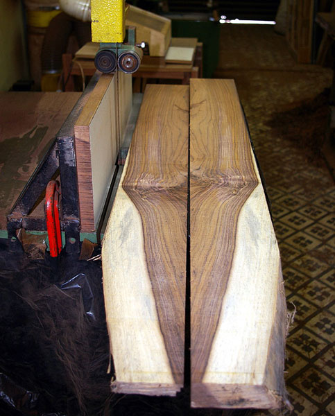

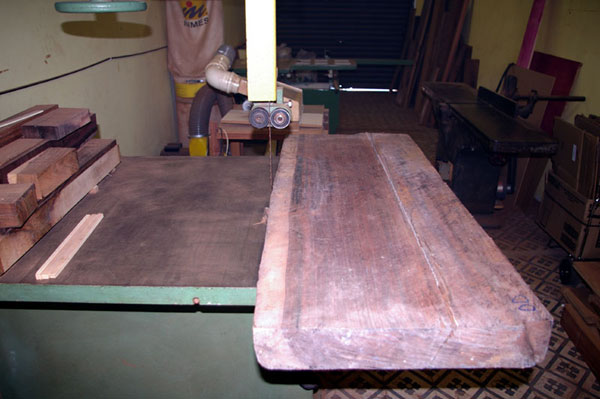

John..I've been struggling with the resawing issue for a couple of months now. I've asked a lot of questions, read a lot online and just resolved the issue by trial and error basically. Everyone recommended a 1" blade and that was what I was trying to use. Nothing seemed to work. Nothing seemed to cut the BRW I am working with. However, I found one article online that recommended a 1/2" blade...so I tried that. That basically solved my problem. And to find Carbide blades here in Brazil isn't as easy as in the states. So, I'm using a regular 1/2" blade with 3 teeth per inch. Take extra time making sure everything is set on the saw...guide and roller bearings are adjusted correctly and the depth roller is set correct. Now the resawing is a piece of cake. I'm cutting 9 1/2" wide BRW for backs and they are so accurate a couple passes through the thickness sander and they're done. I'm now enjoying what was a real chore before. I would recommend a 1/2" blade. It's working great for me. Here's an example of the billets I'm cutting.
Bob..I've heard that a lot about Lacewood. Funny thing is I haven't experienced that at all. Actually the Lacewood I have cuts like butter and isn't hard on my blade at all. It's actually very light wood and has a very high tap tone ring to it. It's real high on my list for great tone.Brazilwood38747.8612037037

[QUOTE=Brazilwood] Bob..I've heard that a lot about Lacewood. Funny thing is I haven't experienced that at all. Actually the Lacewood I have cuts like butter and isn't hard on my blade at all. It's actually very light wood and has a very high tap tone ring to it. It's real high on my list for great tone.[/QUOTE]
Jeff those are some fine looking billets. Jeff the Lacewood I have is anything but light. It is from Brazil.(Roupala Brasiliensis)Bobc38748.1811921296
